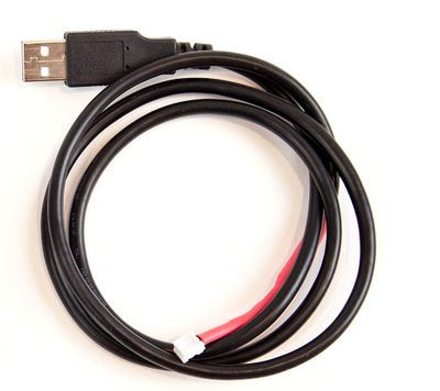

  • Included in your kit is a USB A power cable, with a special connector to power the StereoPi.
As a rule, this cable is included in our Starter and Deluxe kits.

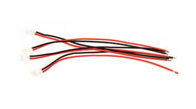

  • If space is tight inside your robot or enclosure, another cable, like this one, can be used to power the StereoPi instead of the USB cable. You can solder power source you wish (like BEC on your RC model), or assemble USB power cable for on-table experiments.

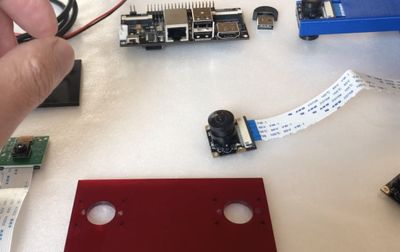

Installation of a basic V1 and V2 cameras is obvious, but you might have some questions about wide angle cameras installation.
You need M2 (2mm diameter) screws. Both Raspberry Pi cameras and StereoPi have a M2 holes.
It is recommended to use nylon (not metal) screws. Metal screws or nuts could interfere with some of the components on the camera's PCB. In this case, the camera is detected but unable to capture any video.
