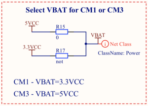

CM1 and CM3 VBAT power
Compute Module 1 needs 3.3V power for VBAT, and CM3/CM3+ needs 5V VBAT.
By default StereoPi is tuned to provide 5V voltage for CM3 series support.
To change powering mode for CM1 support you need:

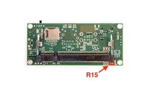

1. Unsolder R15 (0 Ohm) resistor here:
R15 resistor StereoPi

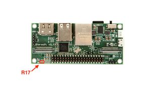

2. Solder R17 (0 Ohm) resistor or piece of wire here:
R17 resistor StereoPi

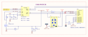

Undeclared feature: usb client mode
StereoPi usb switch
StereoPi usb switch
You can easily access CM's USB on MicroUSB connector. You need to unplug the power cable, and connect StereoPi's MicroUSB cable to your computer without installing USB SLAVE jumper. In this case DD4 USB switch will connect CM's USB pins directly to MicroUSB connector. Onboard USB and LAN will be disabled, and you can use usb-gadget API to turn on RNDIS LAN, usb camera or other modes on StereoPi according to your aim.
If you connect StereoPi by MicroUSB cable to your computer AND install USB SLAVE jumper, you will turn on firmware upload mode. Start rpiboot.exe to make eMMC visible as external drive.
