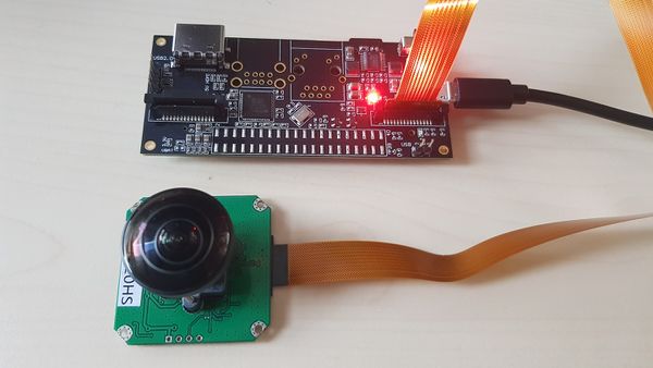

Connecting two 18MP Arducam (UC-549, AR1820) to the StereoPi
StereoPi and Arducam
This topic was inspired by this discussion on our forum.
There are two ways to configure this solution. The first one is to configure StereoPi pins (changing dt-blob.dts and compiling it to dt-blob.bin), and the second way is to change Arducam's driver configuration.
Here is the solution for the second approach (cited from our forum):
Now I managed to get two Arducams to work by looking into the dt_blob.dts and mapping the right pins.
In case somebody has the same problem:
In the Arducam SDK there is a method called "arducam_init_camera2(&camera_instance, cam_interface)".
Here you can specify some camera-pins manually over the "cam_interface" struct.
For the Arducams you need the following camera_interface struct (I got the pin numbers out of the dt_blob.dts):
   struct camera_interface cam_interface = {
       .i2c_bus = 0,           // /dev/i2c-0  or /dev/i2c-1
       .camera_num = camera_num,        // mipi interface num
       .sda_pins = {0, 28},    // enable sda_pins[camera_num], disable sda_pins[camera_num ? 0 : 1]
       .scl_pins = {1, 29},    // enable scl_pins[camera_num], disable scl_pins[camera_num ? 0 : 1]
       .led_pins = {39, 30},
       .shutdown_pins ={44, 45},
Special thanks to user 'fshero'!
