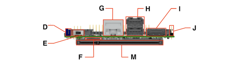

StereoPi Front Noted

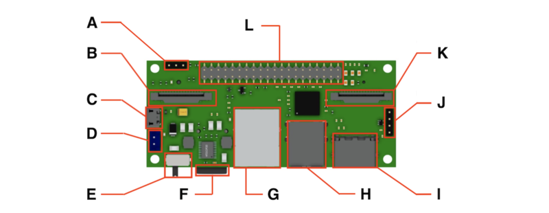

StereoPi Top Noted
StereoPi Top Noted
A. boot mode jumper
B. camera 1 CSI-2 connector
C. micro USB (for firmware upload)
D. 5 VDC power connector
E. power switch
F. microSD slot
G. RJ45 Ethernet jack
H. dual USB Type-A connector
I. HDMI out
J. USB port pin header
K. camera 2 CSI-2 connector
L. 40-pin RPi GPIO header
M. RPi Compute SO-DIMM connector

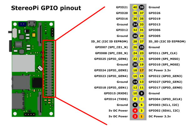

StereoPi GPIO pinout
To preserve Pi hats compatibility (electrical and physical) we kept the original Raspberry Pi GPIOs but rotated them 180 degrees.
StereoPi GPIO
StereoPi GPIO

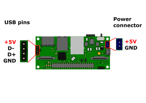

USB pins, power pins
StereoPi USB pins, power pins pinout
