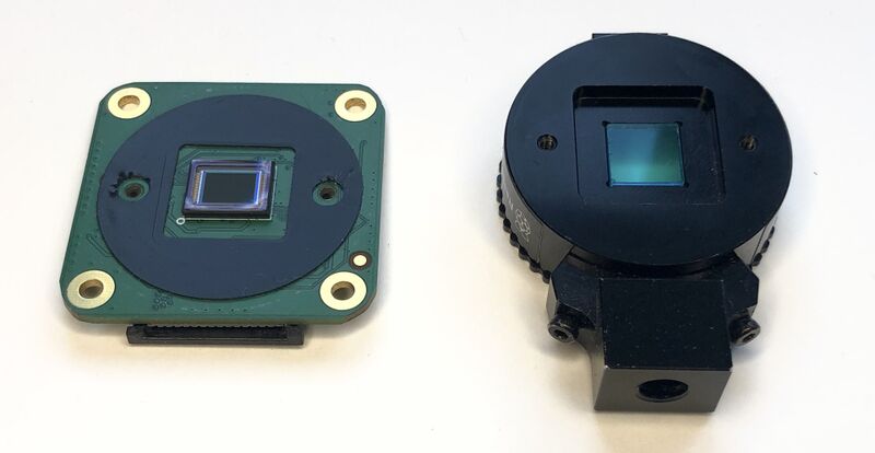

HQ camera is able to see in IR and UV spectrum. But in this case, the colors of the image will be "abnormal". To fix this issue IR filter is used. In HQ camera it's a small piece (8.9mm x 8.9mm x 1mm) piece of glass. We included two such filters in the HQ housing kit. They are exactly the same as used in HQ cameras.
If you want to take regular images and video - you need to install this filter.
If you are planning to do some experiments with IR or UV vision, you can pass this step.

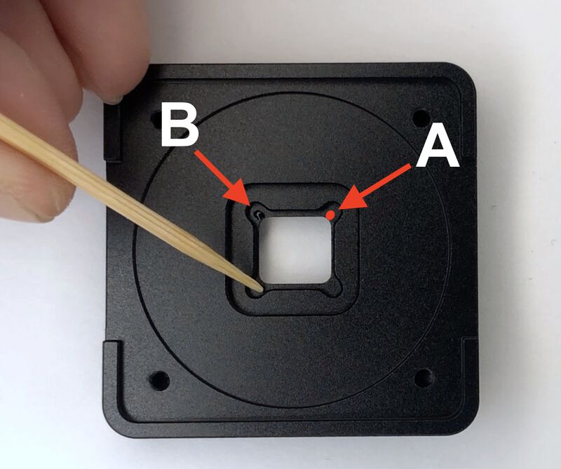

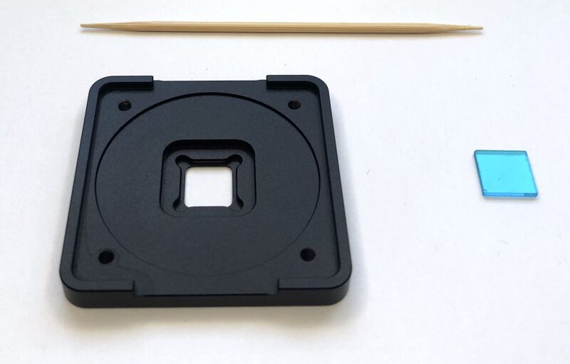

To do this installation you will need a couple of black carriages from the kit, two IR filters, a toothpick, and glue.
Note: please do not use the cyanoacrylate "one-second" glue! Its condensed vapors can leave traces on the filter. Also, it is too liquid and can stain the filter. The best glue to use is transparent thick one like Henkel Pattex.
A drop of glue
A drop of glue
Using the toothpick, please put tiny drops of glue in each corner.
The ideal size of a drop is marked by A in this photo.
The real drop example is marked by B.
Put the IR filter into the carriage. Try not to leave fingerprints on the filter. And let the glue dry.
You should get these assemblies as a result:

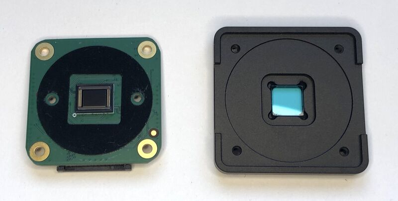

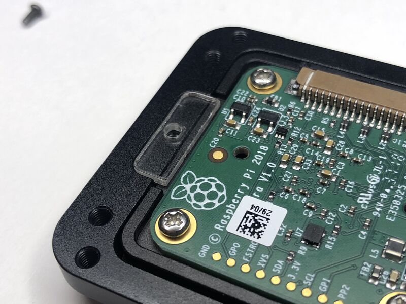

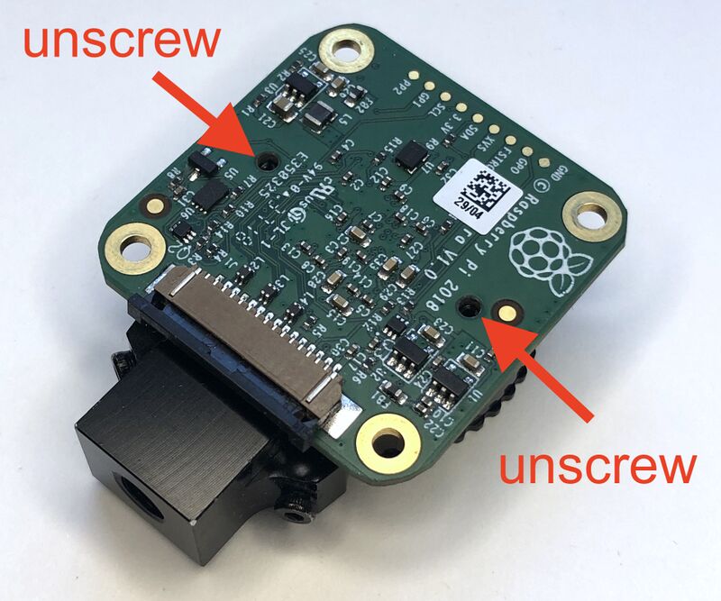

HQ camera disassembly
Unscrew two screws on the backside of each HQ camera.
HQ camera disassembly, part 1
Carefully detach the camera board from the metal part.
HQ camera disassembly, part 2

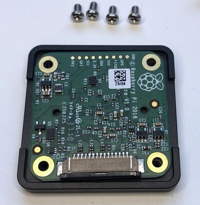

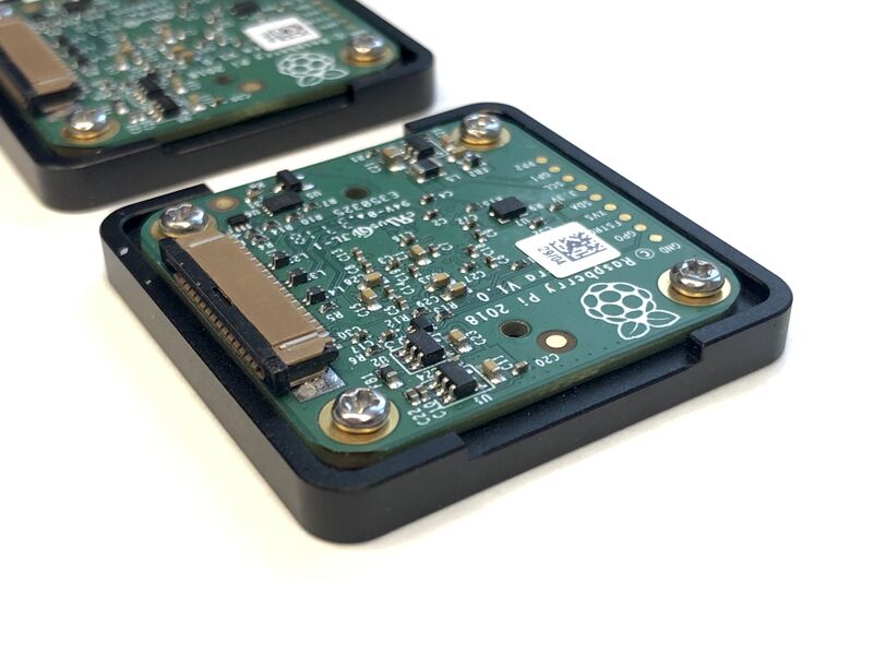

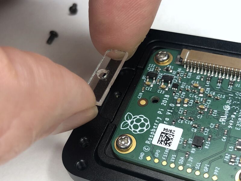

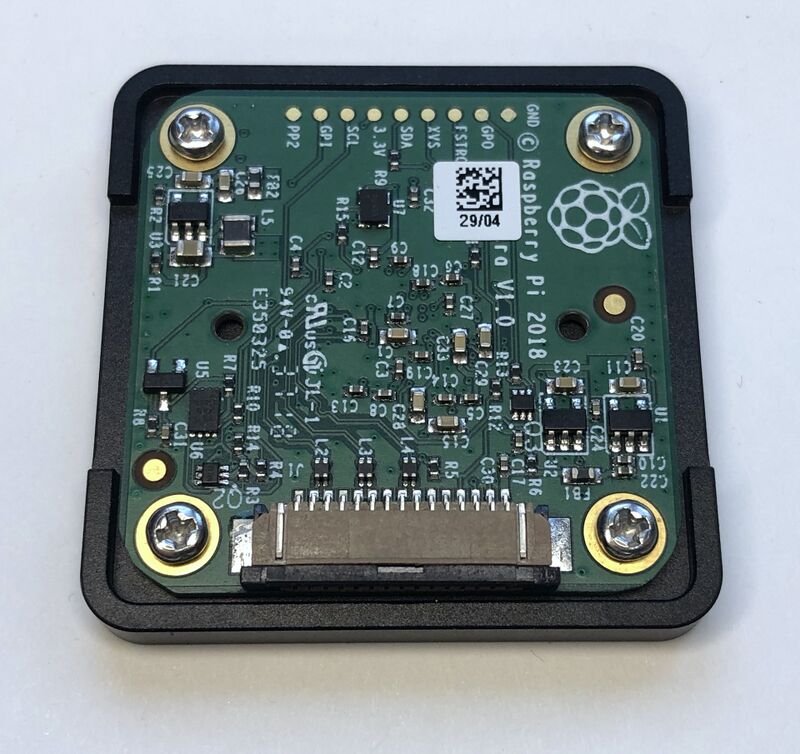

Installation of HQ camera to the carriage
For this step, you will need the HQ camera PCB with the sensor, and the carriage with IR filter installed.
HQ installation to the carriage
Put the camera inside the carriage.
Check the camera connector is faced to the side of the carriage without a notch!
HQ camera in the carriage, step 1

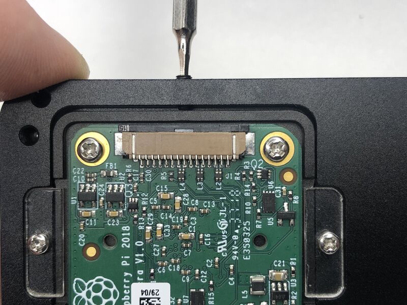

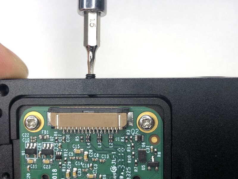

Align the camera inside the carriage and secure it using 4 screws from the kit:
HQ camera in the carriage, step 2

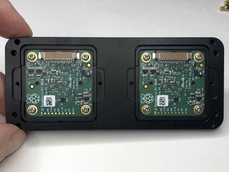

You should have this couple of carriages with the cameras as a result:
HQ cameras in carriages

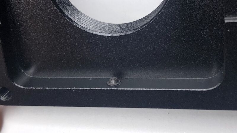

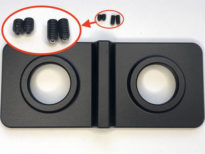

No-ball plungers installation
Install no-ball plungers
Install no-ball plungers, step 2
Carriages installation
Install carriages
Install carriages
Ball plungers installation

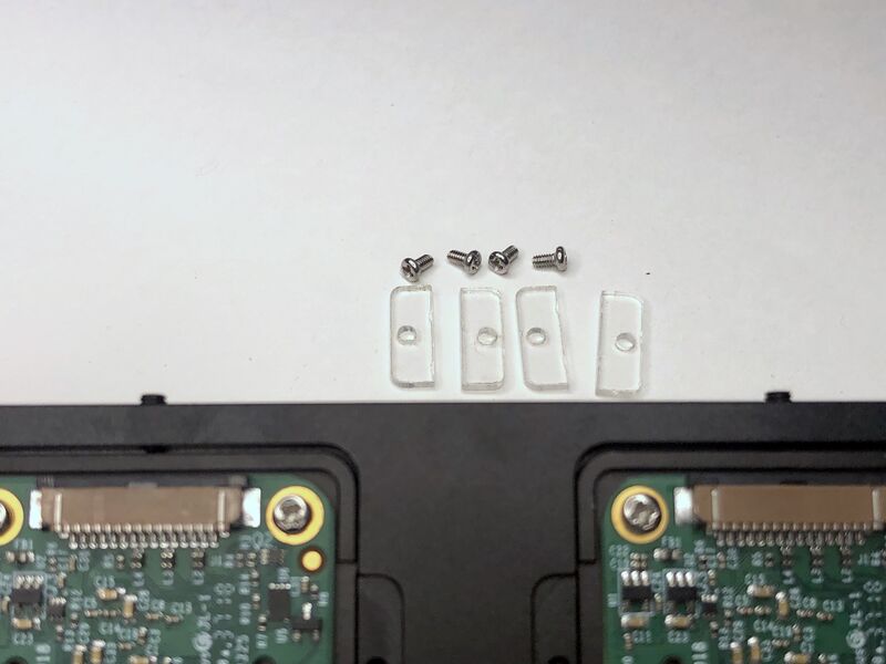

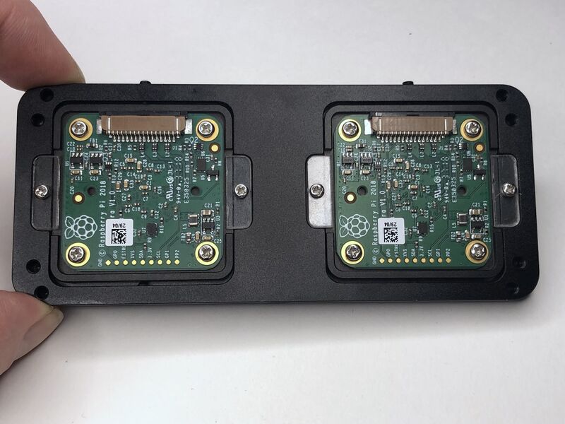

Carriages' fixators installation
Carriages' fixators installation, step 2
Carriages' fixators installation, step 3
Carriages' fixators installation, step 4
Carriages' fixators installation, step 5

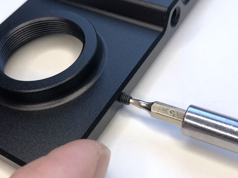

Secure ball plunger
Secure ball plunger

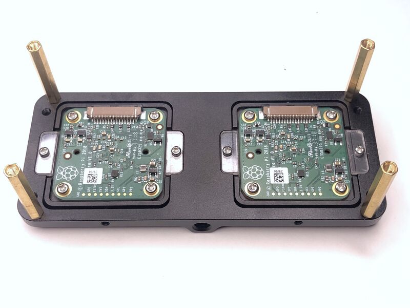

Brass spacers installation

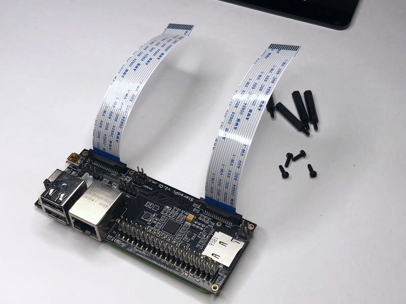

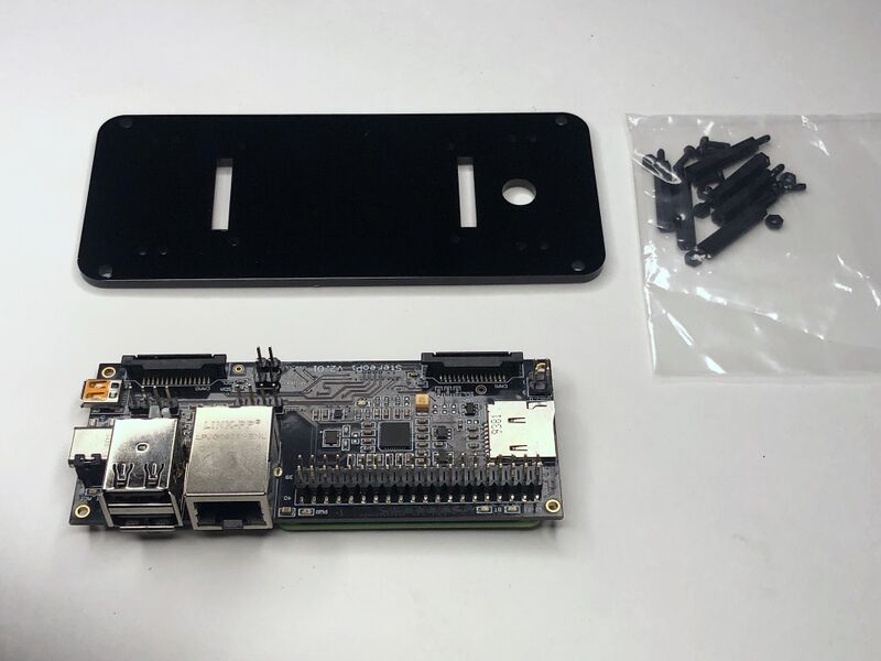

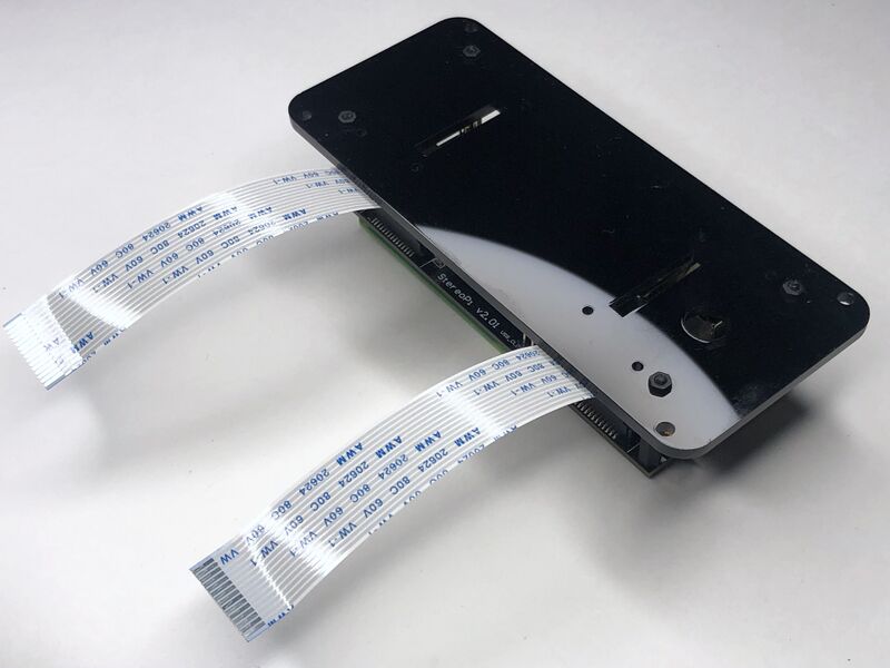

StereoPi v2 installation to the backplate
StereoPi v2 installation, step 1

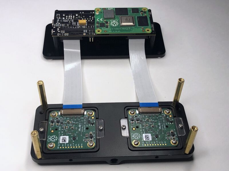

StereoPi v2 installation - connect ribbon cables

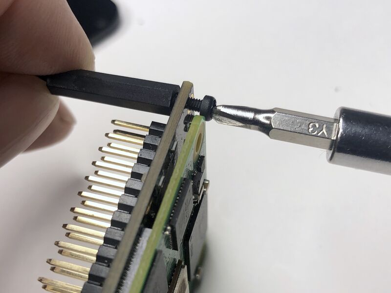

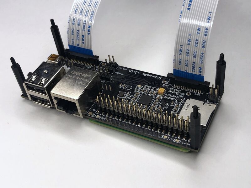

Secure four nylon spacers using nylon bolts
StereoPi v2 with the spacers

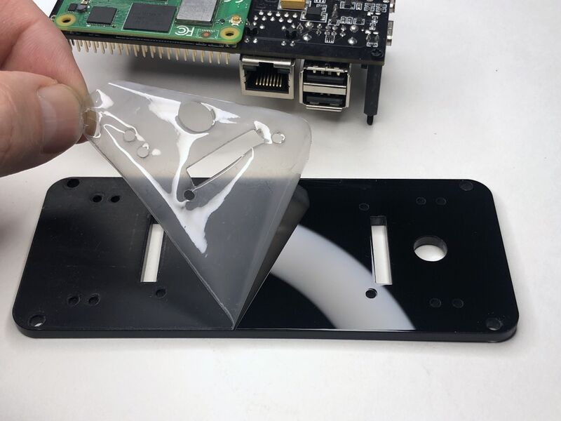

Remove the safety film from the backplate

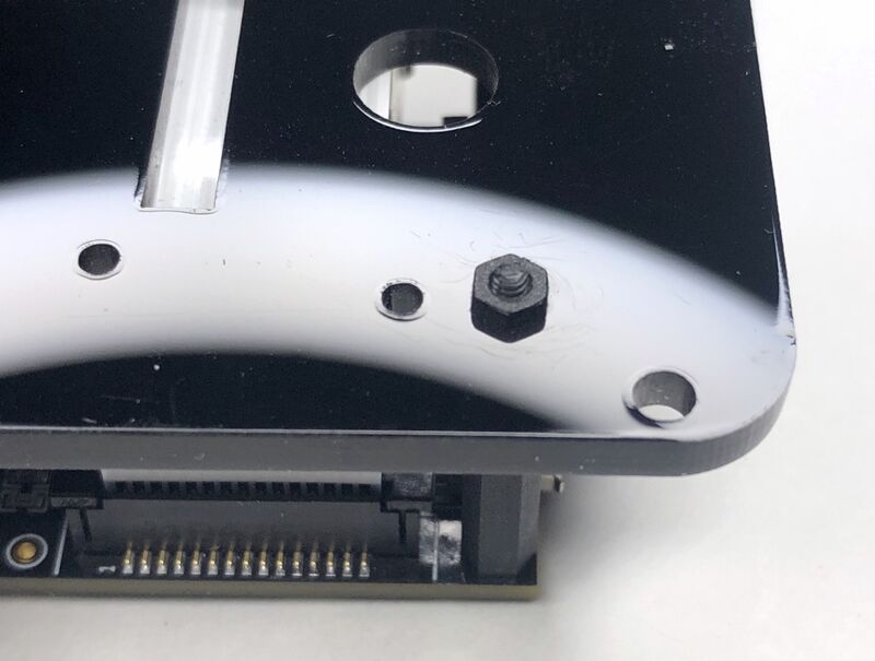

Secure backplate with nylon nuts

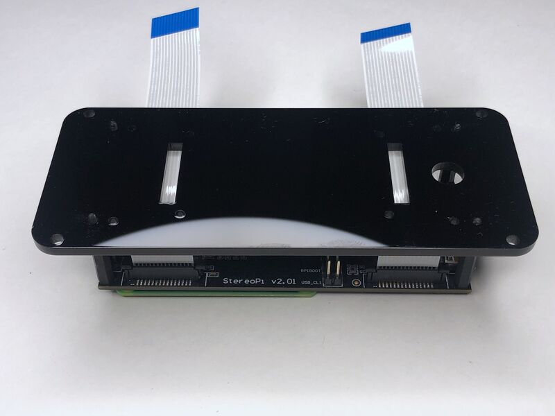

StereoPi v2 with the backplate attached (HQ housing)

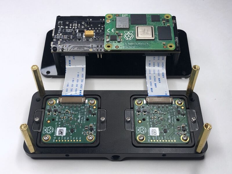

Connecting HQ cameras' cables
Connect HQ cameras
Connect HQ cameras
HQ cameras with 5cm ribbon cables

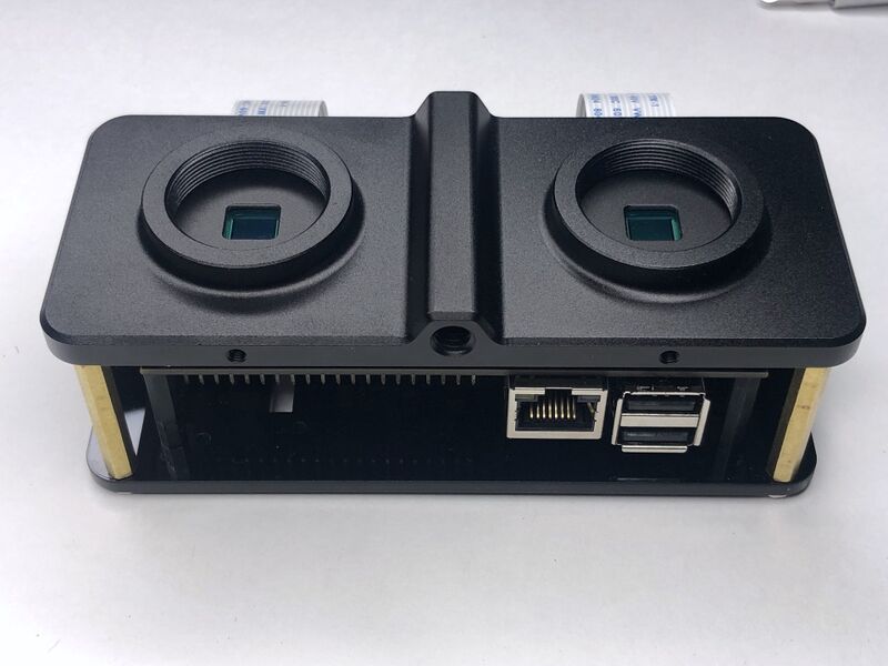

Assembling the front and back together

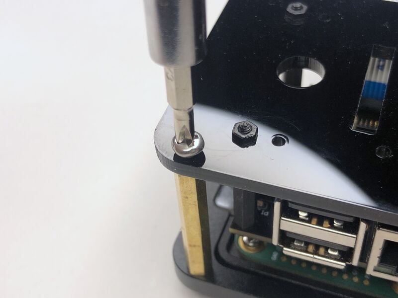

Secure the backplate using metal screws

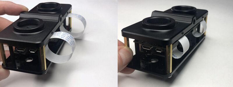

The result of the assembly
10cm and 5cm assemblies comparison

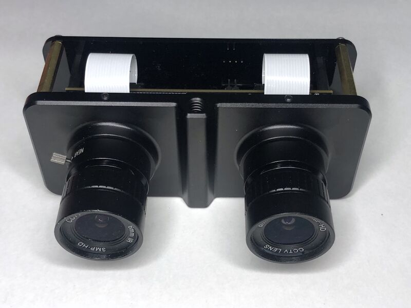

StereoPi v2 with HQ housing and two 6mm CS lenses

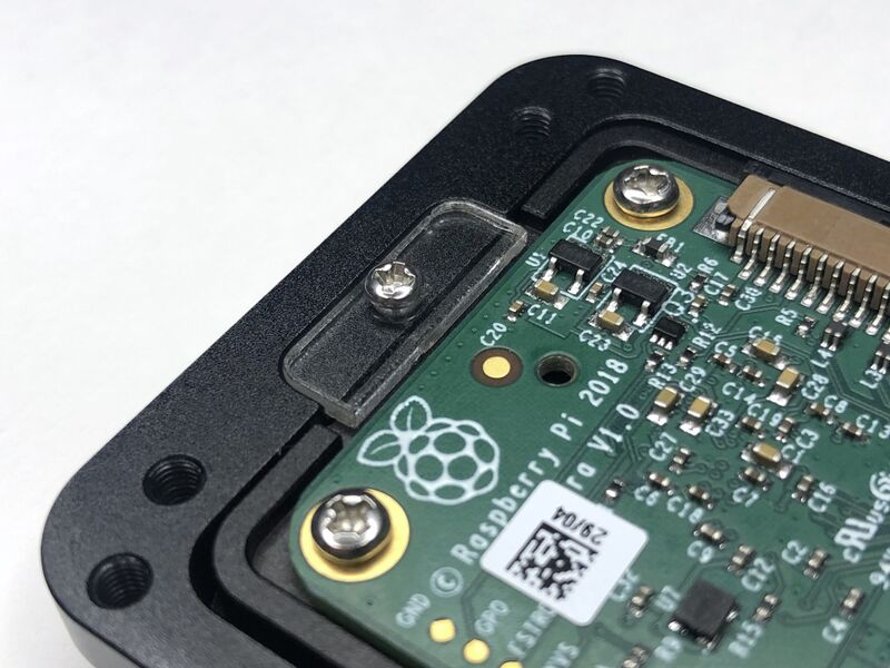

<><><> This page is being updated now! <><><>
