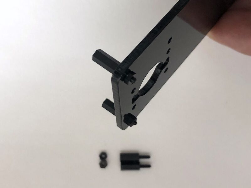

Camera mounting plate preparation

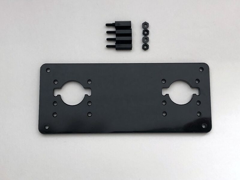

1. Prepare the camera mount plate, four nuts, and four 10mm spacers
Front plate, 10mm spacers and nuts

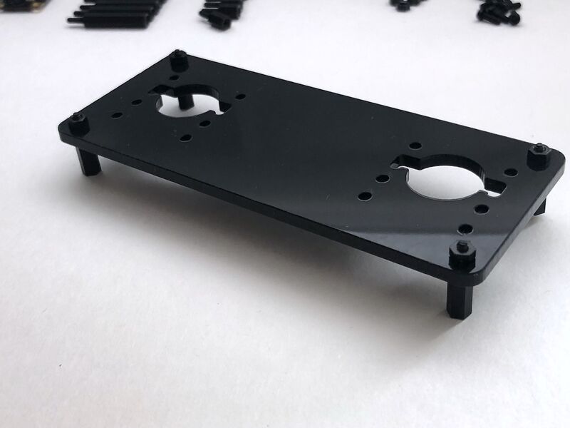

2. Install the spacer to the hole in each corner and secure it with the nut
10mm spacers installation
3. You should get this assembly as a result:
10mm spacers installed

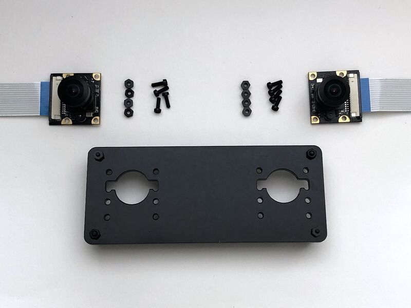

Please prepare two cameras, eight nuts, and eight bolts. You will also need the front camera plate assembled in the previous step.
Cameras, nuts and bolts

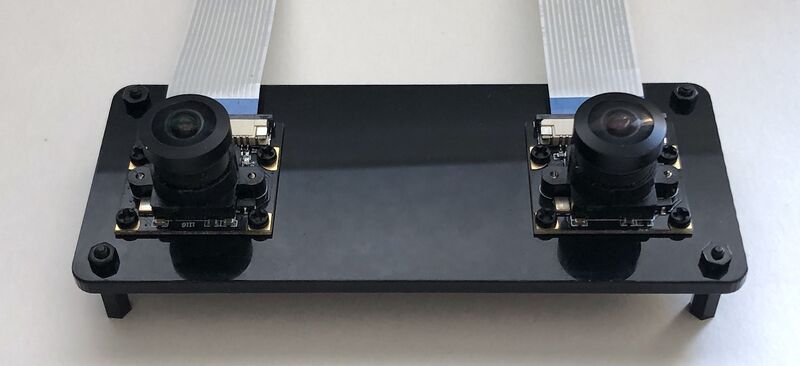

Install the second camera the same way. You should get this assembly as a result:
Both cameras are installed

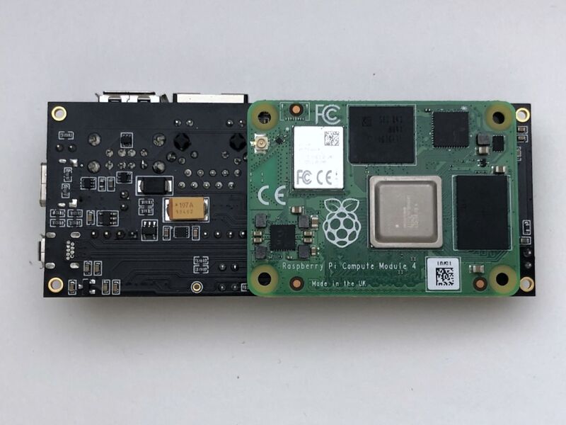

CM4 installation
CM4 installation
CM4 installation
  1. Disconnect all external equipment and power.
  2. Put the board upside down so that the USB C port is facing to the left.
  3. Take the CM4 module so that the triangle PCB antenna and the power circuit (a group of 5 black components) are faced to the left.
  4. Put the CM4 module on the connectors and gently press the bottom until you hear a click. After that, do the same with the top part of the CM4.
After this step you should get this result:
CM4 installation result

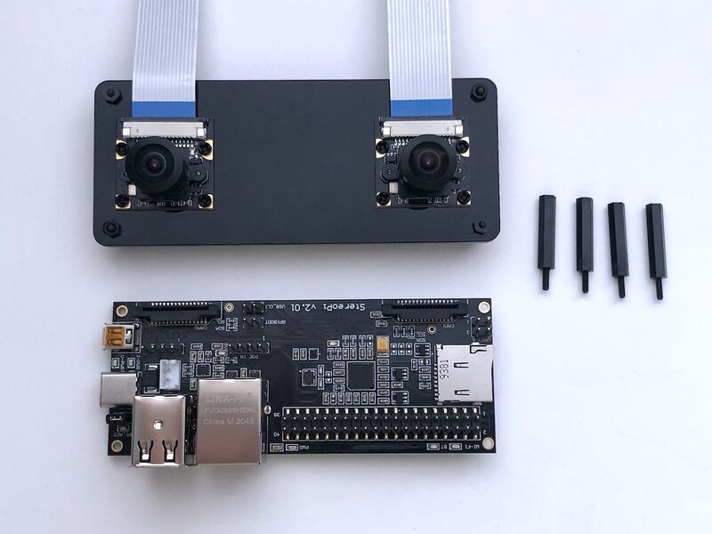

For the next step you'll need all items you've just assembled, and also four 20mm spacers.
StereoPi v2 installation

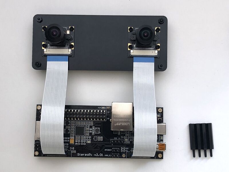

You can use camera ribbon cables of different lengths, so this step may vary.

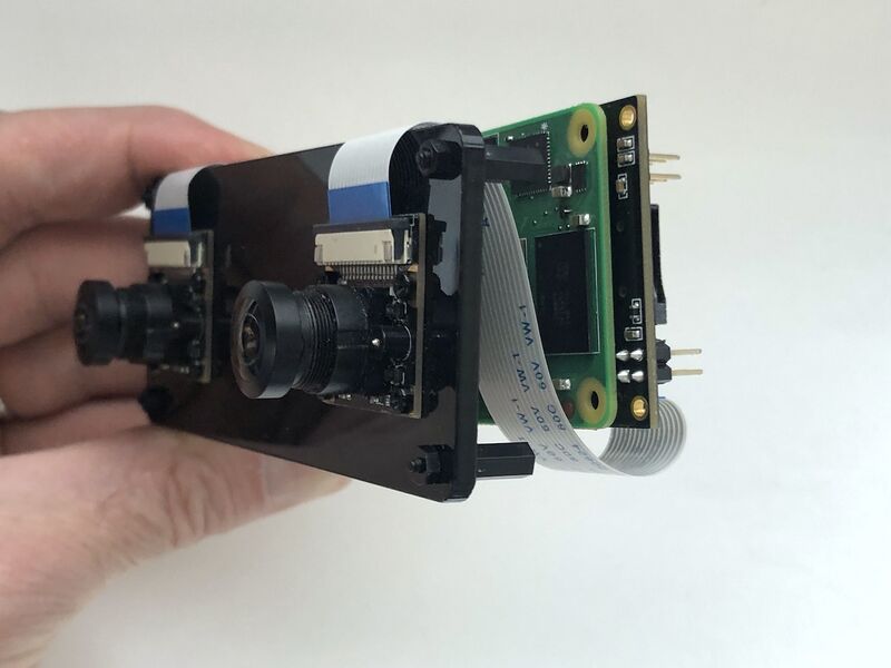

Choose the most appropriate ribbon cables' position for your assembly, and put StereoPi v2 board to the spacers, attached to the camera mount plate. Here is how we did it for the 10cm cables:
Camera mounting plate installation
After that, secure the board using four 20mm stand-offs. Here is the result of this step:
Camera mounting plate installed

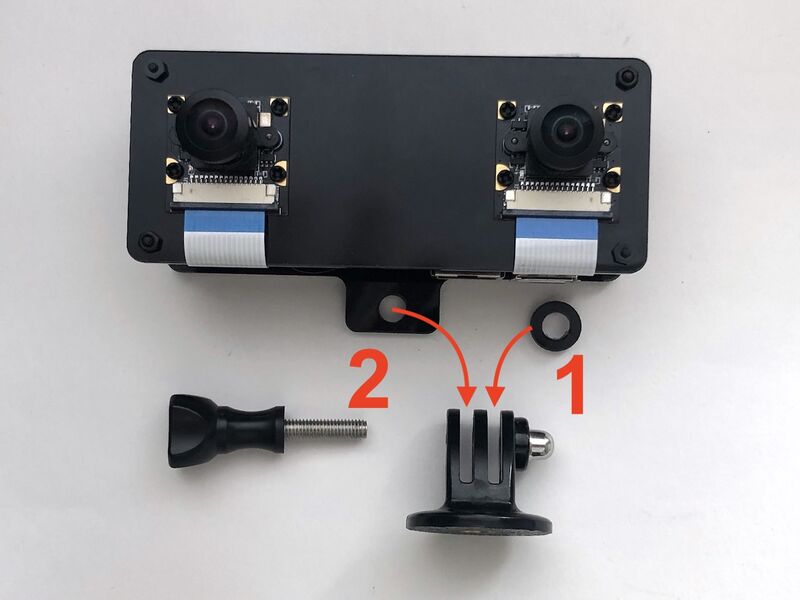

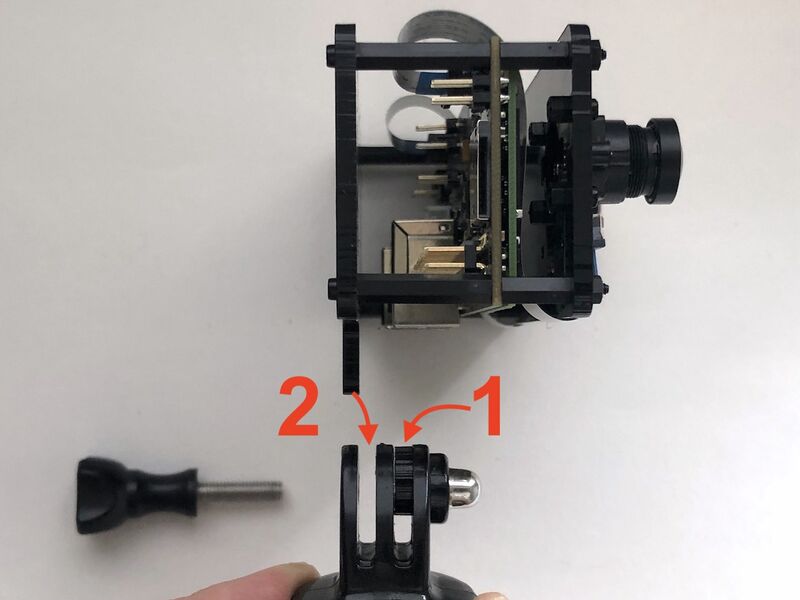

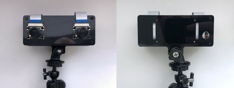

Tripod mount installation
Prepare the GoPro mount add-on and the black acrylic circle from the kit.
Install the acrylic circle near the metal part of the GoPro mount first:
Tripod mount installation, step 2
Install the StereoPi assembly keeping the cameras facing the metal part of the GoPro mount, and secure the assembly using the metal screw included.
Tripod mount installed

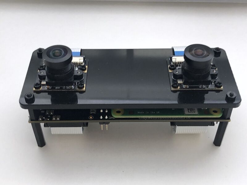

Elevated installation of the cameras
In the first section of the assembly guide, we considered the simple approach of the camera mounting:
Simple assembly
Simple assembly

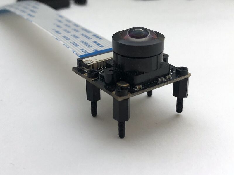

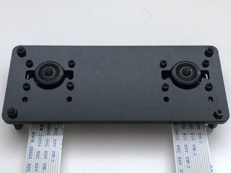

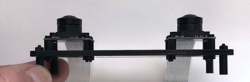

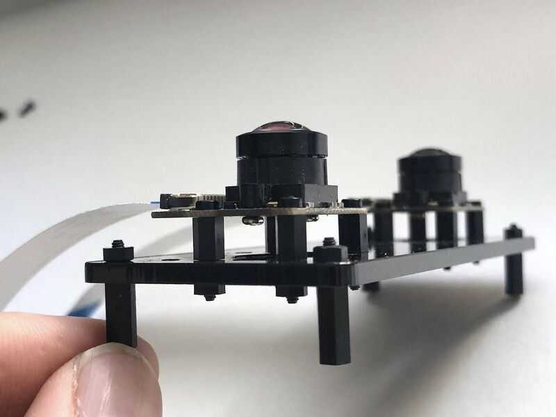

If you are planning to experiment with different cameras and want to be able to replace them without the full disassembly, it is better to use the "elevated" camera installation, like this one:

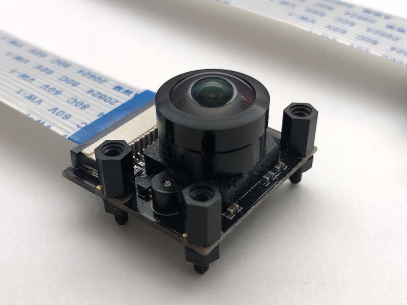

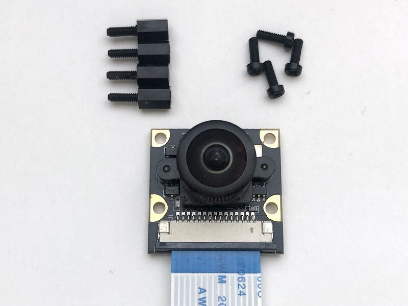

To do this assembly, use four 6mm spacers and four bolts.
Camera, spacers and bolts
Secure the spacers using the bolts:
Elevated camera assembly
Then install both cameras to the mounting plate:
Elevated cameras installed

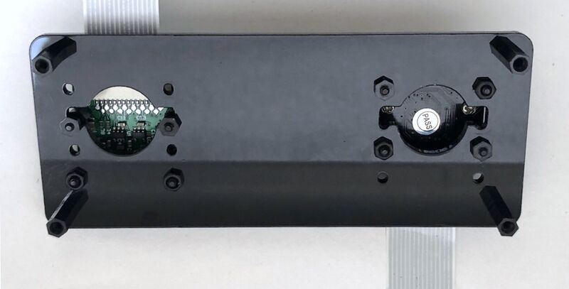

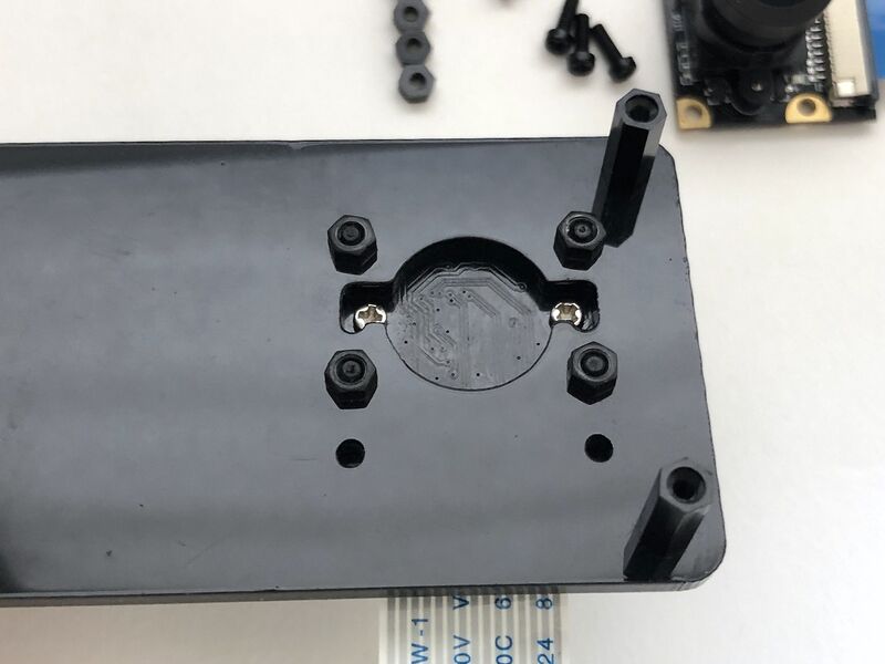

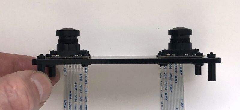

Recessed installation of the cameras
This method is useful with the StereoPi Slim edition. You can also use it in some specific cases, when you have to hide the cameras' PCB and ribbons behind the mounting plate.
Attach the spacers by nuts this way:
Recessed camera installation
Install both cameras to the mounting plate:

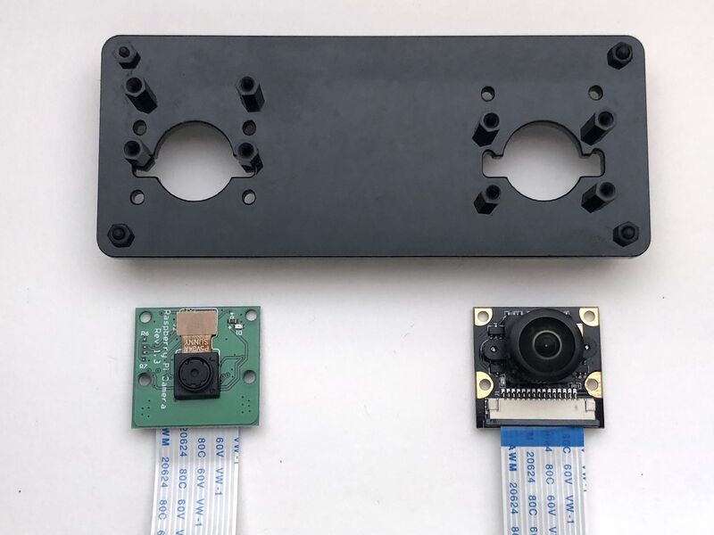

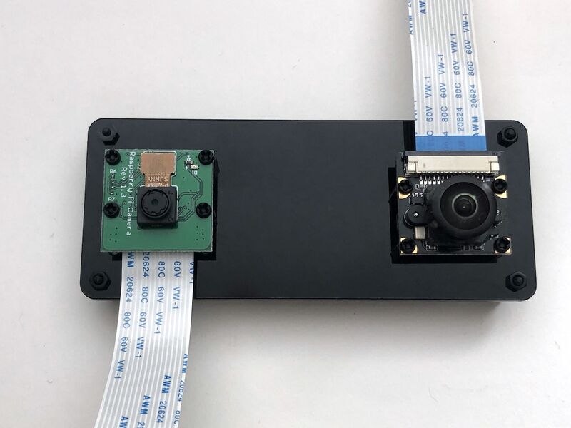

Installation of Pi Cameras V1 and V2
We recommend using the elevated installation of the V1 or V2 cameras.
Since these cameras have another position of the holes, you should use additional holes of the mounting plate.
To simplify the installation difference indication, let us show you both versions of the cameras installed on the same plate.
Caution: using two cameras with different sensors will cause raspistill/raspivid issues. Please access the cameras using low-level system methods if you really need this mix of sensors for your experiments. In our photo, we are using v1 camera and M12 both equipped with OV5647 sensors, so this couple will work with the raspistill/raspivid without issues.
v1 and M12 installation difference
V1 and M12 installation difference, part 2
V1 and M12 installation difference, bottom view

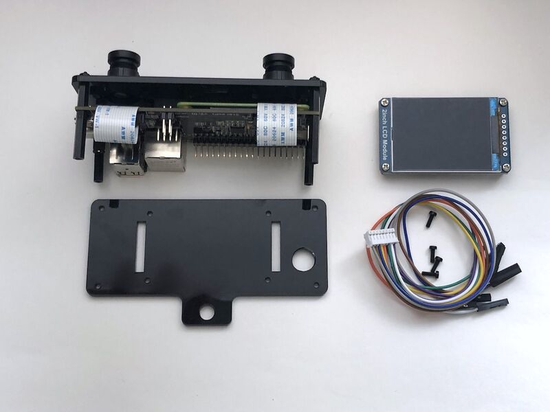

Screen and shot button installation

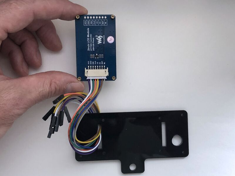

Connecting the TFT screen
Screen installation
Screen installation

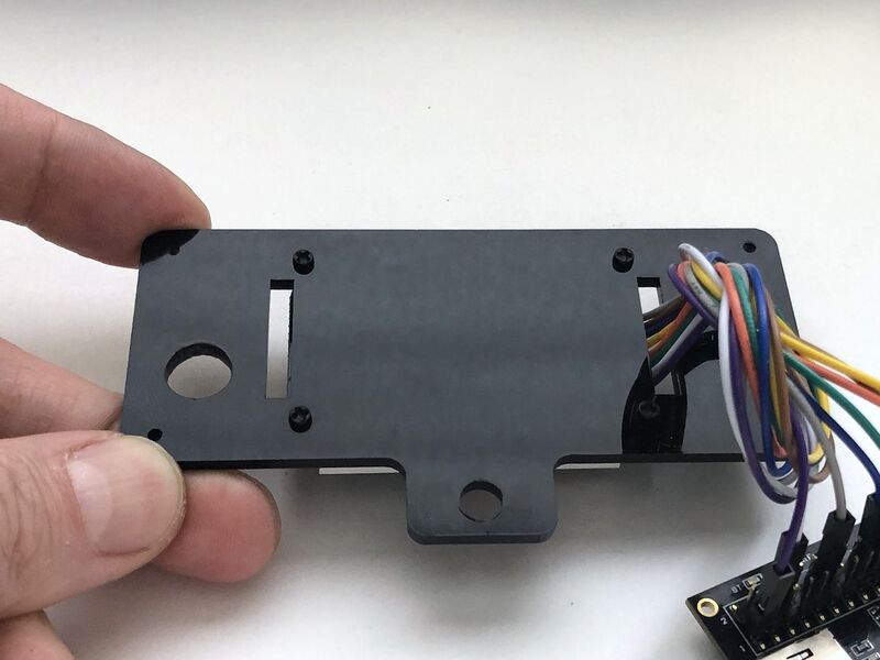

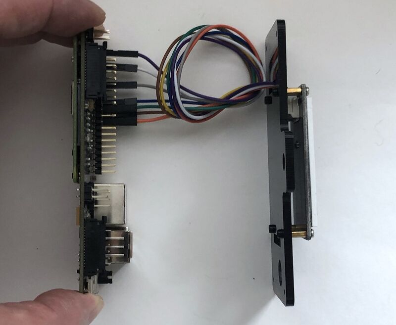

Push the screen's wires through the hole:
Screen installation: step 1

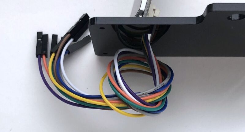

For simplicity of future assembly make a knot, but do not tighten too tight!
Cable management
Cable management

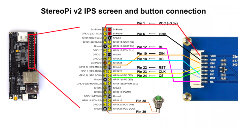

ATTENTION! The color of wires may vary! Please use the name of the pins to connect, and ignore the colors!
Connect the screen wires to the StereoPi v2 GPIO according to this diagram:
Screen and button connection diagram

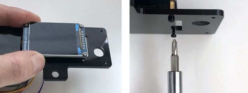

Secure the screen using four bolts from the kit.
Secure the screen
Secure the screen

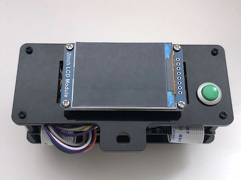

And our assembly looks like this now:
Screen attached
Screen attached

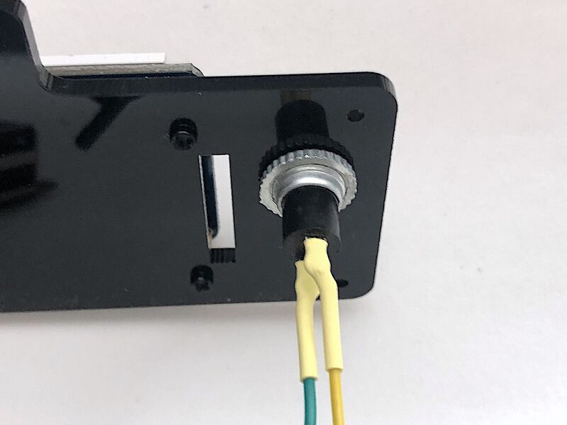

Connecting the button
Now let's install the shot button. As an example, we'll connect it to the GPIO 20. Please use this GPIO 20 in the SLP2 setting to enable this button functionality.
The Button
The Button

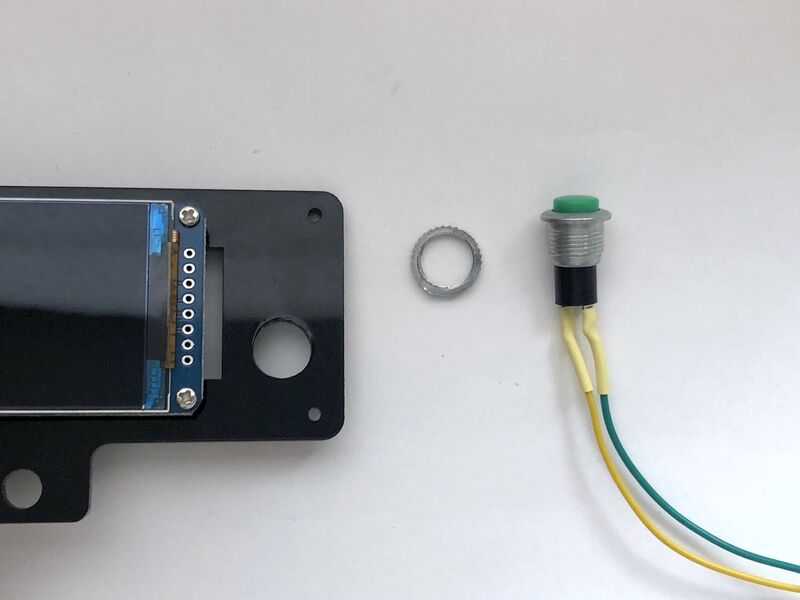

Install the button into the hole:

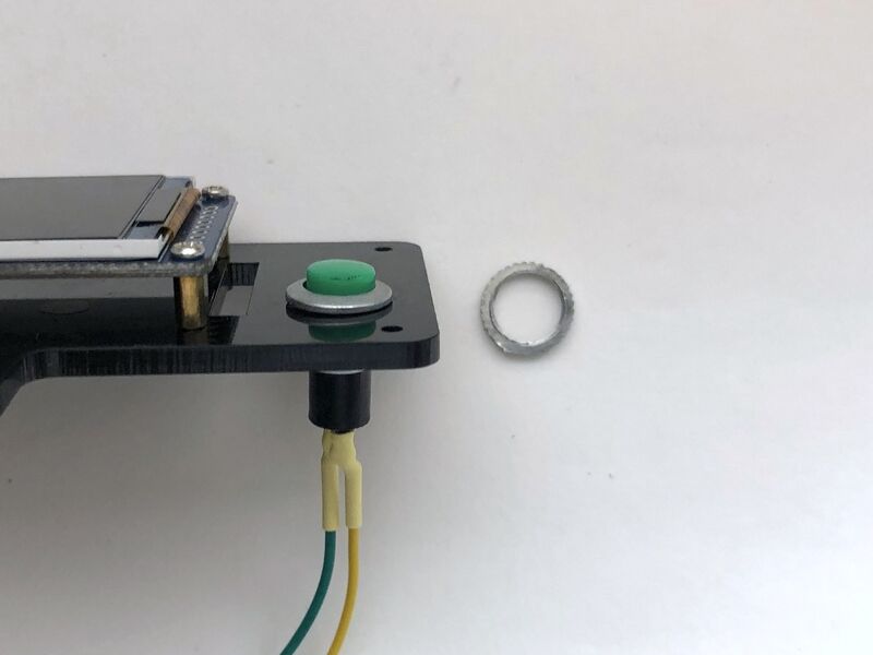

Secure the button from the bottom side by the metal nut included:
Secure the button
Secure the button

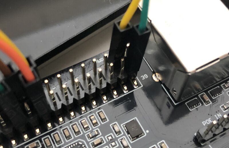

Connect the button's wires to pins 38 and 39 according to this diagram:
And we have this connection:
Button pins (GPIO20)

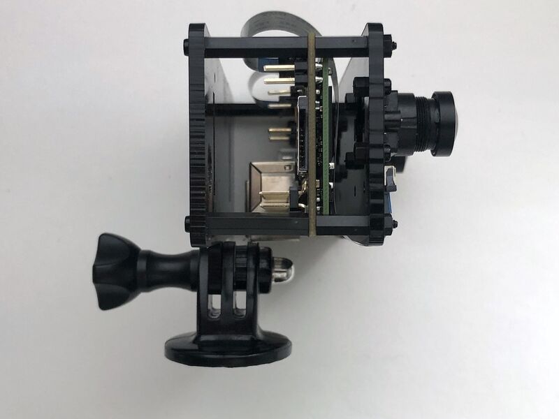

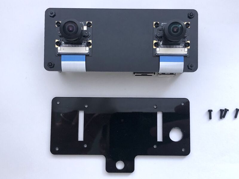

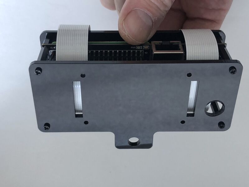

Now install the backplate to the main assembly with the StereoPi:
The screen and the button are installed
And a side view of our assembly:
The screen and the button are installed, side view
