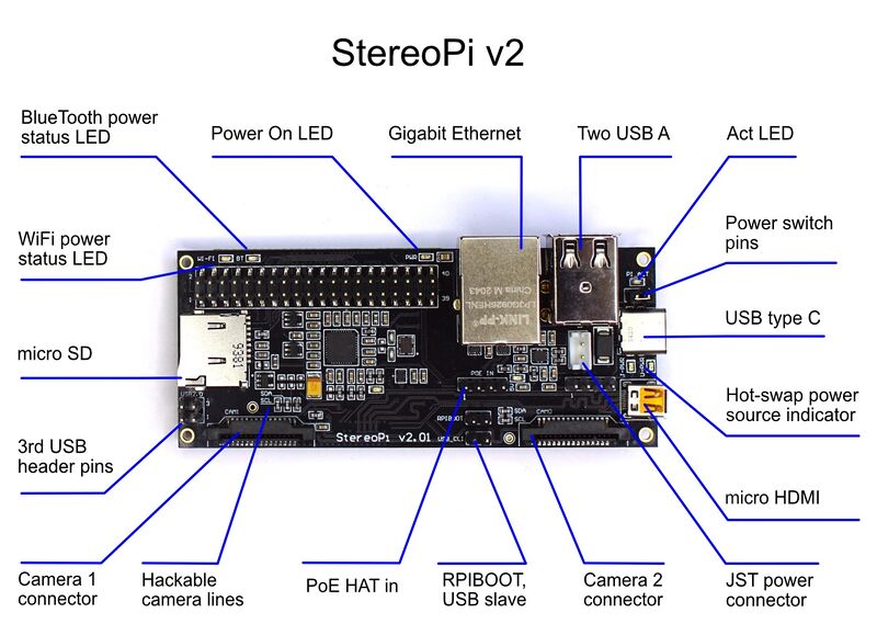

StereoPi v2 ports and connectors diagram

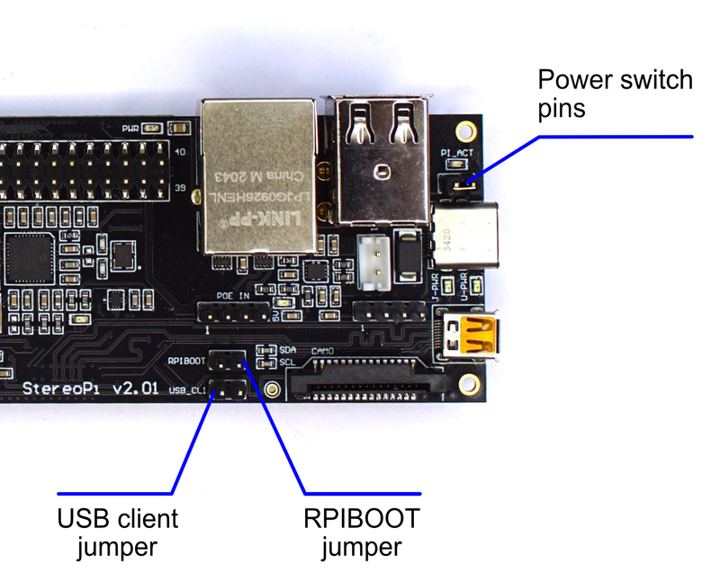

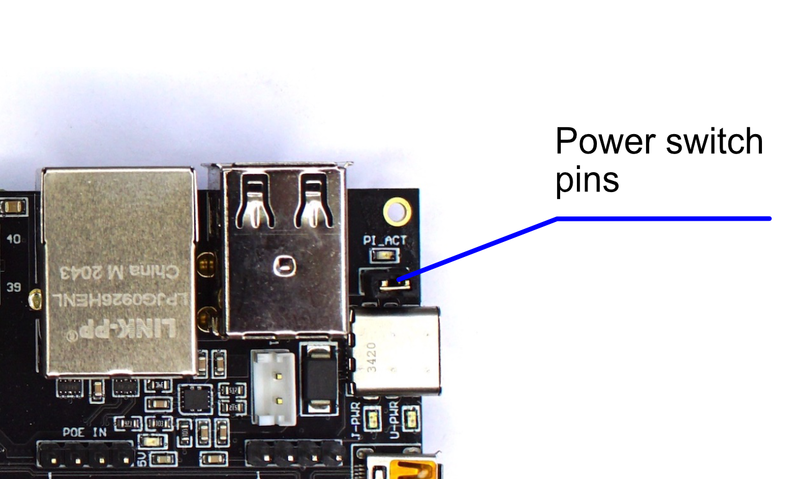

Power switch
Power switch pins
Power switch pins
Install a jumper to the pins near the USB C connector.
To find these pins you can refer to the full ports and connectors diagram.
YouTube video: Power Switch
Note: advanced users can use external buttons or equipment to turn on/off the board.

CM4 eMMC upload jumpers configuration (StereoPi v2)
If you are using CM4 with the onboard storage (eMMC), you need to turn on the usbboot mode.
To do this:
  1. Install the RPIBOOT jumper
  2. Install the USB_CLI jumper
  3. Check the power jumper is installed
After that StereoPi v2 is ready for the eMMC upload. To access your eMMC you can follow the official Raspberry Pi Guide.

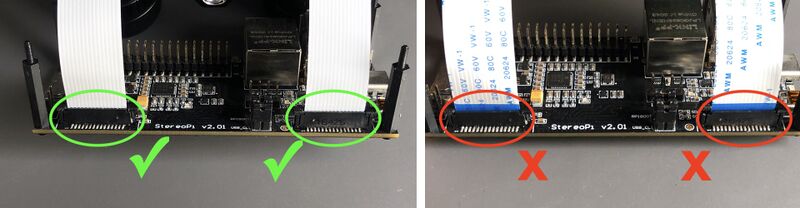

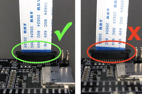

While connecting camera ribbons, the first step is gently PULLING black the locking tab up 4-5 mm. After that insert camera ribbon by BLUE side to BLACK locking tab. Check that the cable is fully inserted at a 90-degree angle. After that push the black locking tab down to secure the ribbon.

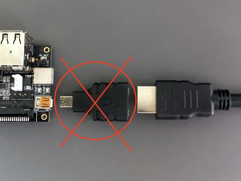

HDMI monitor connection caution
Do not use a micro HDMI to HDMI adaptor
Do not use the micro HDMI to HDMI adaptor. Using it will increase the risk of breaking the StereoPi's micro HDMI connector.
Most of the regular full-size HDMI cables are not flexible, and this adaptor will transmit all external physical load to the micro HDMI connector of StereoPi v2.
Please use a flexible micro HDMI to HDMI cable instead.

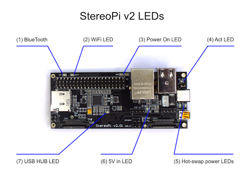

StereoPi v2 LEDs
StereoPi v2 LEDs
StereoPi v2 LEDs
(1) BlueTooth power indicator
Indicates the power of the BT module. If BT is not powered, this LED is off.
You can "brutally" disable the BT power by adding this line to the config.txt:
dtoverlay=disable-bt
(2) WiFi power indicator
Indicates the power of the WiFi module. If WiFI is not powered, this LED is off.
dtoverlay=disable-wifi
(3) Power On LED
This LED is indicating the CM4 status. If CM4 power cirCuitry feels good and powers up all CM4 stuff, this LED is on.
(4) ACT LED
This LED indicates the micro SD access activity. It is actively blinking during the boot process, and less active later.
(5) Hot-swap power LEDs
J-PWR LED:
- has a green light if JST power is connected and detected
- has an orange color if JST connector power is used by the StereoPi now
U-PWR LED:
- has a green light if USB-C power is connected and detected
- has an orange color if USB-C connector power is used by the StereoPi now
(6) 5V in LED
This LED is on when the StereoPi is powering up the CM4. If you remove the power jumper, this LED will be turned off.
(7) USB HUB LED
This is a legacy LED from the epoch of USB2513 HUB debugging. It is used only if the USB hub is connected by I2C and set to the programming mode. Currently USB EEPROM programming feature is disabled but can be enabled by advanced users.
