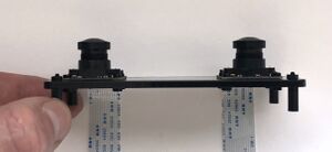

Install the second camera the same way. You should get this assembly as a result:
Both cameras are installed
