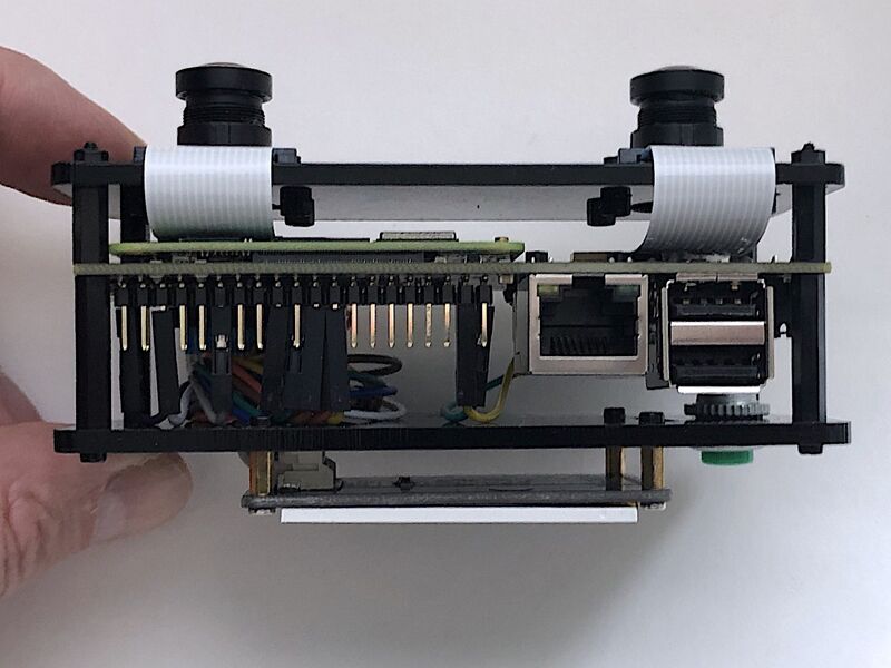

Screen and shot button installation
Connecting the TFT screen
Push the screen's wires through the hole:
For simplicity of future assembly make a knot, but do not tighten too tight!
ATTENTION!
The color of wires may vary! Please use the name of the pins to connect, and ignore the colors!
Connect the screen wires to the StereoPi v2 GPIO according to this diagram:
Secure the screen using four bolts from the kit.
Here is the backside view of the backplate with the screen attached:
And our assembly looks like this now:
IMPORTANT
- If your screen sows upside-down image, you can either assemble your setup using another slot for the cables of the backplate or do this simple rotation trick shown in [this 26-seconds YouTube video].
- After installation of the screen, do not forget to enable it in StereoPi_v2_Camera_Kit_Guide#Turn_on_TFT_screen_support_in_SLP2.
Connecting the button
Now let's install the shot button. As an example, we'll connect it to the GPIO 20. Please use this GPIO 20 in the SLP2 setting to enable this button functionality.
Install the button into the hole:
Secure the button from the bottom side by the metal nut included:
Connect the button's wires to pins 38 and 39 according to this diagram:
And we have this connection:
Now install the backplate to the main assembly with the StereoPi:
And a side view of our assembly:
