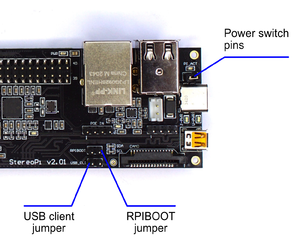

== Power switch == | == Power switch == | ||
[[File:Power-switch-pins.png| | [[File:Power-switch-pins.png|none|800px|Power switch pins]] | ||
Install a jumper to the pins near the USB C connector. | Install a jumper to the pins near the USB C connector. | ||

Power switch
To find these pins you can refer to the full ports and connectors diagram.

If you are using CM4 with the onboard storage (eMMC), you need to turn on the usbboot mode.
To do this:
- Install the RPIBOOT jumper
- Install the USB_CLI jumper
- Check the power jumper is installed
After that StereoPi v2 is ready for the eMMC upload. To access your eMMC you can follow the official Raspberry Pi Guide.
