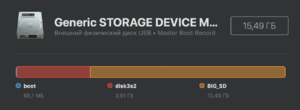

Partition structure
Classic Raspbian has two partitions: BOOT and a Linux filesystem. Our image has both of them (using 4Gb on MicroSD), and also offers 3rd partition in Fat32. It is used for recording captured video. So after recording a video, you can insert MicroSD into your computer and see all your records, as with your car dashcam.
SLP partitions structure

Tip1: Not all MicroSD marked as 16Gb have the exact same size. Win32DiskImager may warn you that your MicroSD is too small, but you have the option to “continue”. For this case we leave several hundreds of unused spaces at the end of MicroSD, so image will not be broken on such cards.
Tip 2 for advanced users: Main system use only 4 Gb on MicroSD, and other ~12 Gb is used for video records. If you have only 8 Gb card, you may record our SLP image too with Win32DiskImager. But after that you need to manually fix broken Fat32 partition (create it again and format).

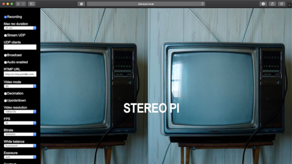

1. Open a browser and type:
http://stereopi.local
Important: This method works on MacOS, iOS and Windows 10 only!
Admin panel will appear. In some networks it works immediately, but in other networks it might take some time to find and open panel (10-20 seconds). You will see Administration panel:
SLP administration panel

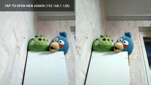

2. Open our Android application. It will automatically find your Pi, connect to it and start playing livestream video. If you tap on the screen you will see a prompt with an IP address. If you tap on it, then browser will be opened with Admin panel.
StereoPi Android Application Screenshot

This simple application automatically connects to Pi with SLP image, requests video livestream and shows it.
If you use StereoPi and “3D” mode enabled in Admin panel – you can enjoy 3D video by putting your phone to google cardboard-like device. We like ColorCross and Pocket 360 solutions.
ColorCross and Pocket 360 VR sets
If you use classic Pi, you can see video livestream from your camera without any additional equipment.
Tap on the screen to show prompt with current IP address of Pi.
Clicking on this prompt will open browser with Admin panel.

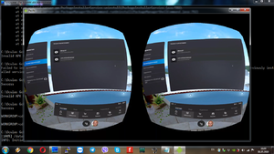

You can also use this application on Oculus Go as we did. Put your Oculus Go in developer mode and upload application. At this moment there are no joystick support for Oculus, and we plan to add it later.

Oculus Go application
Stereopi in unknown sources
For Oculus Go please use special edition of our APK file.
StereoPi-OculusGo.zip
In this ZIP file you will find StereoPi.apk file for uploading to Oculus Go Use sideload to upload this to the Oculus Go (for example, adb.exe utility).

SLP Admin panel options
Recording
If you turn on this feature, Pi will record all video to MicroSD card.
Max rec duration
Recorded video will be cut on pieces with a chosen length.
Why do you need it? The answer is simple. We capture “raw” h264 stream from a camera. If you record it directly, you will feel some problems while viewing it in your video player. For example, scroll may not work etc. So we need to convert it to MP4 for comfort use. Our SLP does it on-the-go. But to do it correctly our utility needs to add some information to the file. If you turn off your Pi during this process, you may lose your last record, but all previous records remain safe.
What time to choose? For short on-table experiments it is better to set minimal time (30 seconds). For real-life experiments it is better to set 5-10 minutes.
Stream UDP
Section for advanced users. You may put IP addresses and ports of devices you want to livestream to.
You may use several comma-separated values in “UDP clients” field, like this:
192.168.1.10:3000,192.168.1.20:4000
To capture this stream you may use your own application or gstreamer (see Advanced User’s Section).
UDP clients
Field for UDP clients (for Stream UDP option).
Broadcast
Turn on or turn off video livestream.
Audio enabled
If you connect USB sound card with Microphone, or USB microphone, system will try to stream video with sound.
RTMP URL (YouTube etc.)
If you put RTMP string here, Pi will send the livestream to it. For livestream to YouTube you need to copy livestream link from your YouTube studio and put it in this field. Our link looks like this:
rtmp://a.rtmp.youtube.com/live2/9k1d-2ue3-xxxx-xxxx
Trick:
YouTube does not allow livestream without sound. So if SLP has not detected a USB soundcard and microphone, it adds fake silence sound to this stream, and it works. If you have USB soundcard and mic, you will hear sound on YouTube.
Tip:
If you have no experience on YouTube livestream, you should know that YouTube adds a time buffer of up to 30 seconds for your video. That is, you will not see your video immediately, and when you see it, you can find some delay. It is not a bug, but a feature. It helps viewers to obtain smooth and high-quality video.
Video mode
Choose 3D if you have StereoPi or another Pi-based solution with two cameras connected. Choose 2D if you have classic Raspberry Pi. If you use this option with StereoPi, only one camera will be used for video capture.
Decimation
This option compress each taken image horizontally to 50% of its original width. This feature is useful for FPV and Depth Map, as you save full FOV (field of view) of your camera. For other implementations you may uncheck this option. In this case FOV will be cropped, but you have normal side ratio of your video. For our Oculus experiment we unchecked this option. In fact this option adds “-dec” parameter to raspivid.
Upside/Down
Rotate image to 180 degree. With 1 camera it is simple. With 2 cameras we do flip and also swap left/right images. Otherwise your left and right images appear in the wrong place, and your brain will be stuck on trying to build 3D image from this.
Video resolution
Resolution of video captured.
FPS
Frames Per Second settings for video. Please notice, that if you choose too high FPS for high resolution you may obtain capture problems. For 1280x720 with ONE camera you may use 48 FPS. For 1280x720 and 3D use 42 FPS. You can experiment with these settings to fit your needs.
We want to notice that highest FPS is critical for at least two scopes. First one is livestream to VR helmets like Oculus, as ease of perception depends on this. The second one is RC FPV, as higher FPS decrease video latency.
Bitrate
Number of megabits used for 1 second of video after compression, in megabits (not megabytes). This settings affects the H264 encoder of your Pi. The higher bitrate, the better video quality you have, and the more bandwidth connection required for livestream. For livestream we recommend to use 2-3 Mbit at HD or FullHD resolution. For 640x480 even 1 Mbit is Ok. Higher bitrates are useful for recording video on MicroSD without livestream. Please notice you need a high-speed MicroSD to record at high bitrates.
White balance
Changes white balance mode.
In this option we implemented options available for Raspberry Pi Camera.
Exposure
Changes exposure mode.
Contrast
Changes contrast mode.
Sharpness
Changes sharpness mode.
Notice: It looks as if this feature has a bug in Raspbian, as it is work with only one camera in stereoscopic mode.
Digital gain
Changes digital gain mode. In this option we implemented options available for Raspberry Pi Camera (https://www.raspberrypi.org/documentation/raspbian/applications/camera.md)
Wifi SSID
Name of your WiFi access point
Can be adjusted here or in stereopi.conf file in a BOOT partition
WiFi password
Password for your WiFi.

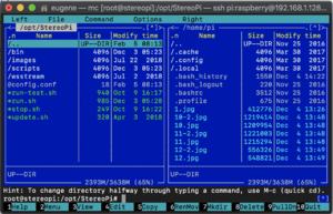

SLP structure details you should know
1. We prepared this image for aggressive usage. That’s why we want to save the filesystem in a case of occasional poweroffs. So by default, filesystem is read-only and you cannot change any file. To unlock it type:
sudo mount -o rw,remount /
2. mc already installed, you may use it.
3. Our streaming scripts are here:
/opt/StereoPi
SLP SSH MC screenshot
If you will enter this directory, you can stop all scripts by running:
./stop.sh
To start them again run:
./run.sh
